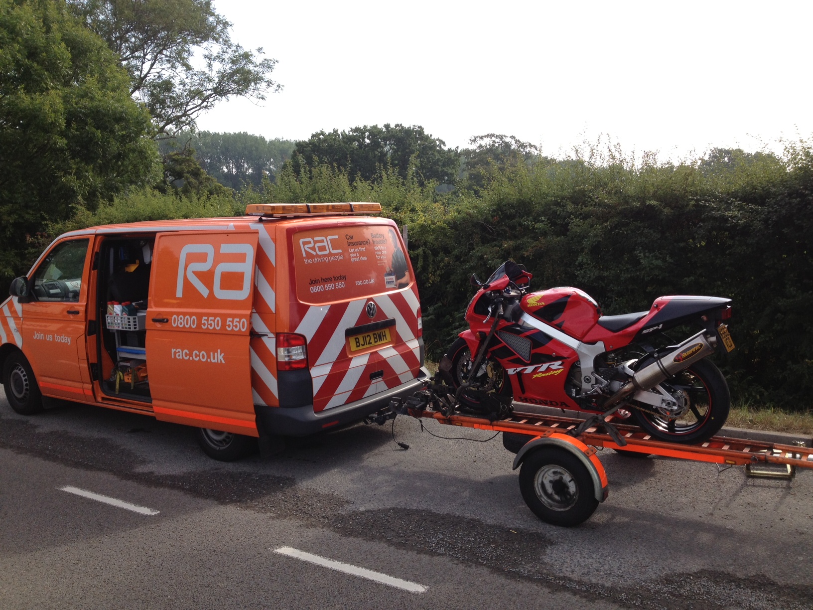

So friday last week I booked a track day at Bedford, was really looking forward to it as I've never been. Set off nice and early at 0500 and made my way down some backroads towards the M25. 15 min later she started to hesitate under acceleration, which got worse and worse up to the point she stalled. Wasn't happy to say the least but even more worried of me being stranded in pitch dark at a bendy hilly back road waiting for a car or lorry to run me over. And damn is she heavy having to push her uphill to make a side road!!!
Once at the side road I started her up again, no problems there!!! Let her run for a min or so, revved her a little bit, again no probe. Hmm what the hell...jumped on and set off again. 10 sec later same thing happened...WTF!!! :angry-banghead: :angry-banghead:
The red F1 light came on as well. So basically she ran fine untill I jumped on.
Called the RAC and after an hours wait a top bloke turned up, well into bikes himself!! Tried several things but to no avail, couldn't work out why she idled fine but stalled within seconds if I drove off. So finally had her recovered to P&H in creepy Crawley. What a sad site to see your baby on the back of a trailer!!! F..k....broke down and no track day....not a good start of the day!!
A couple of days later the rang me up to say that the Power Commander was the problem!! With not much room for the wiring routing under the fuel tank it got squashed over time. No probs if you started her up but once I sat on her and drove off the cable got squashed and played havoc on the bike.
Glad the bike is fine but the PC is knackered, and just had her dyno'd a couple of weeks ago!! Guess gotta have to buy myself a new one.
