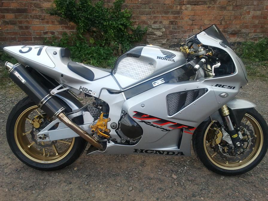

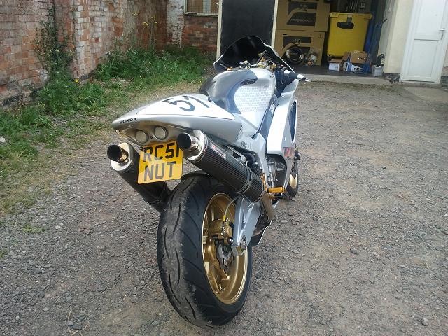

Postby steve p » Sat Sep 10, 2011 4:27 pm
think iv sorted how to post pics.
2011-09-10 11.32.36 - Copy.jpg (143.69 KiB) Viewed 13280 times
2011-09-10 11.32.47 - Copy.jpg (91.83 KiB) Viewed 13280 times

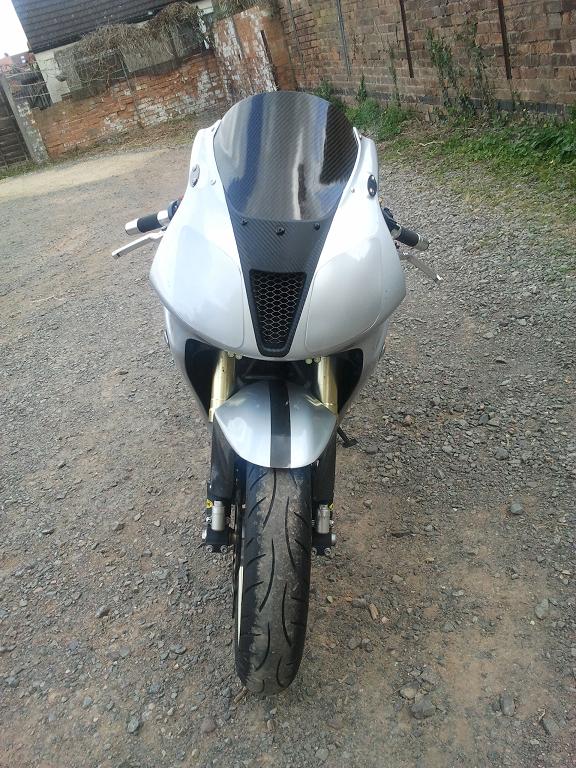

just finished the lens covers, made from fibre glass and rattle canned.
2011-09-10 11.32.01 - Copy.jpg (126.02 KiB) Viewed 13280 times

nice clean bike you got there! :thumbup: :thumbup:
Re: Steve p's bike
Postby Stars and Stripes » Sat Sep 10, 2011 5:46 pm
Unusual colour, I like it alot, :thumbup: really like all the gold bits, :thumbup: your real registration number?? :think:
Re: Steve p's bike
Postby sp1Dave » Sat Sep 10, 2011 6:30 pm
Lovely looking bike Steve :thumbup:
Re: Steve p's bike
Postby steve p » Sun Sep 11, 2011 8:40 am
gets cleaned and tinkered with more than ridden. Never really seen a problem with posting number plate pics, if its to do with identity theft this bike is clearly not standard visually and is kept locked away under close CCTV at my mates shop to prove usage, and its on plane view to anyone while im out riding.
