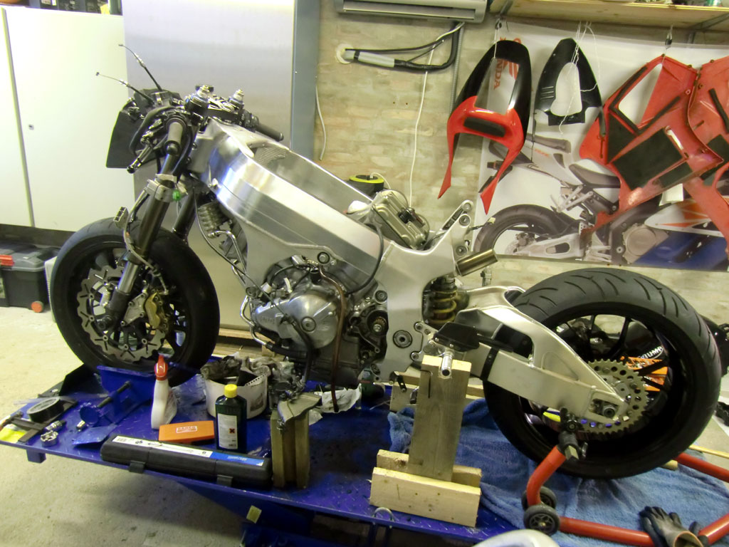

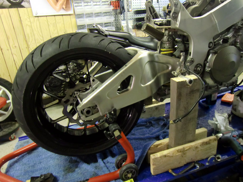

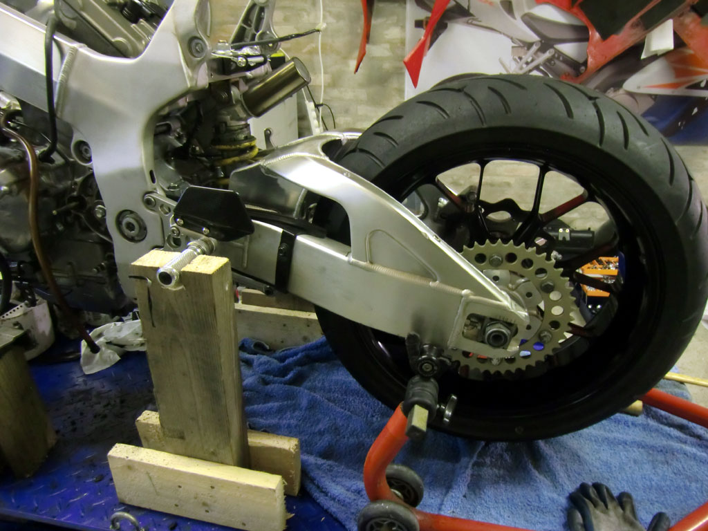

Finally started putting my SP1 back together efter a thorough cleaning. SP2 swingarm is on, and Ive begun fitting the wire-harness.

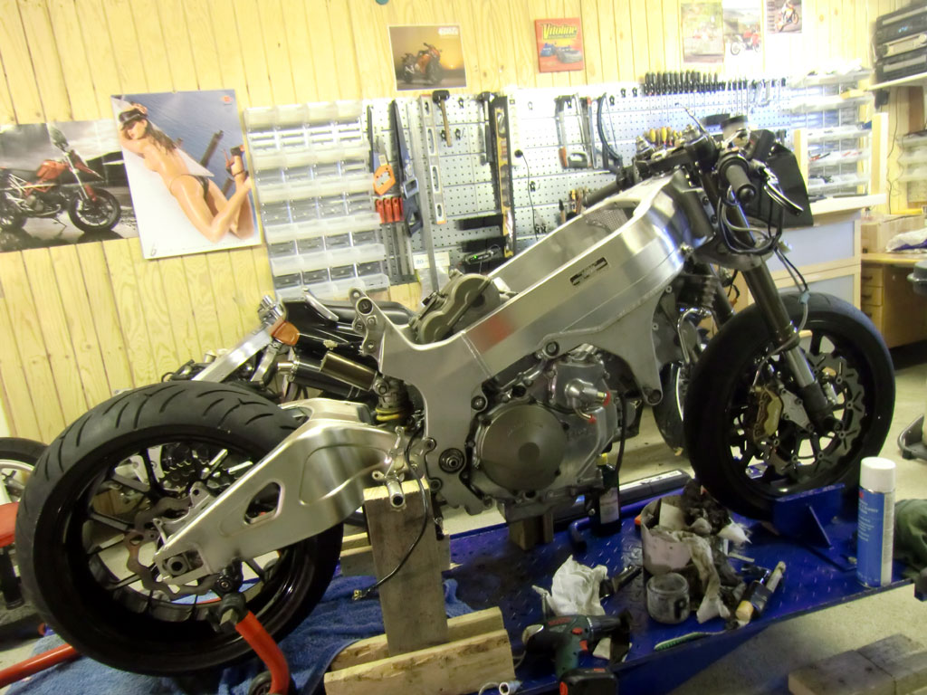

On the last photo, it's good to see you have proper technical documentation on the far wall. :thumbup:

Thats looking good Hanberg! :clap:
Like the SP2 swingarm and love the home made stand's :thumbup:

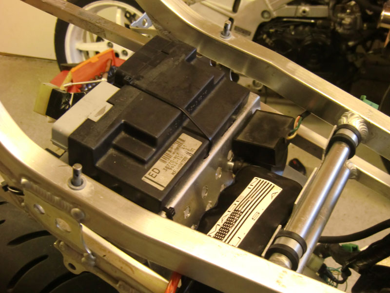

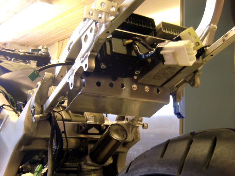

More photos
But damn I hate fitting wires. Everything looks so nice a neat until you start putting on the harness.... Id love to make my own, but dont think I have the patience

Nice, tidy undertray in the making, Not sure that you should mount the regulator/ rectifier unit so close to the ECU though as it usually uses the sub frame as a heat sink and gets very hot, too hot to touch close by! It may be ok but i would mount it well back from the others, just a thought.

He could replace the OEM rectifier/regulator with a Shindengen FH012AA MOSFET type rectifier/regulator as used on current bikes.
Physically smaller, and runs much cooler. Will need an adapter harness to mate the different connectors, but those can be had in kit form.

My friend with the Triumph is already looking at those, the Viffers run fine, so dont think it would matter.
It is a bit close, but there is 10mm air on the mount side of the rectifier, as it put the riv-nuts in from the "wrong" side to make some room.
