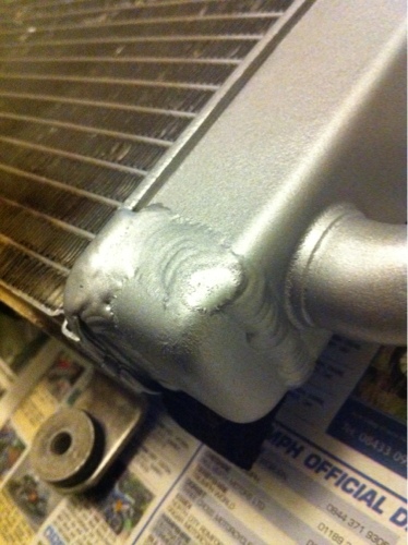

Hmmm, I dunno! I guess the best bet would be to shift the bracket to the body of the rad as opposed to under the fins but maybe that would cause irreparable damage if you chuck it up the road. I suppose in theory with the way they are, the brackets should break off before completely destroying the radiator, but I am basically making this theory up. Have mine in front of me now and it kinda makes sense - but HRC must have considered these options!
Here's the rad repair (I've been away fur a fortnight so now have to do all this outside in this lovely December weather, not much fun!!)

Postby Sppete » Thu Dec 15, 2011 8:10 am
Looks as good as new :thumbup:
