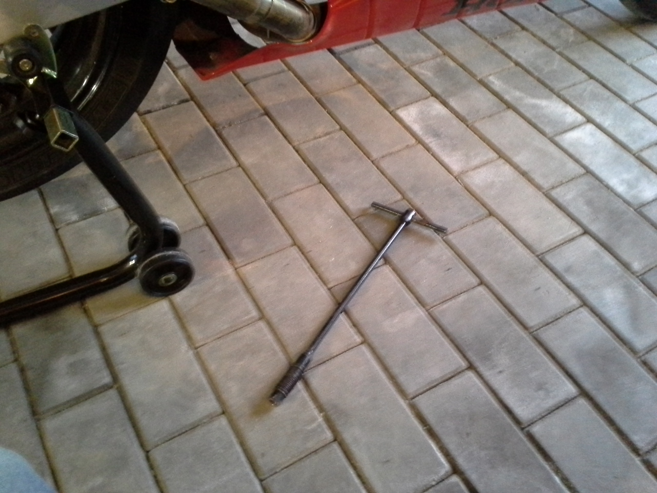

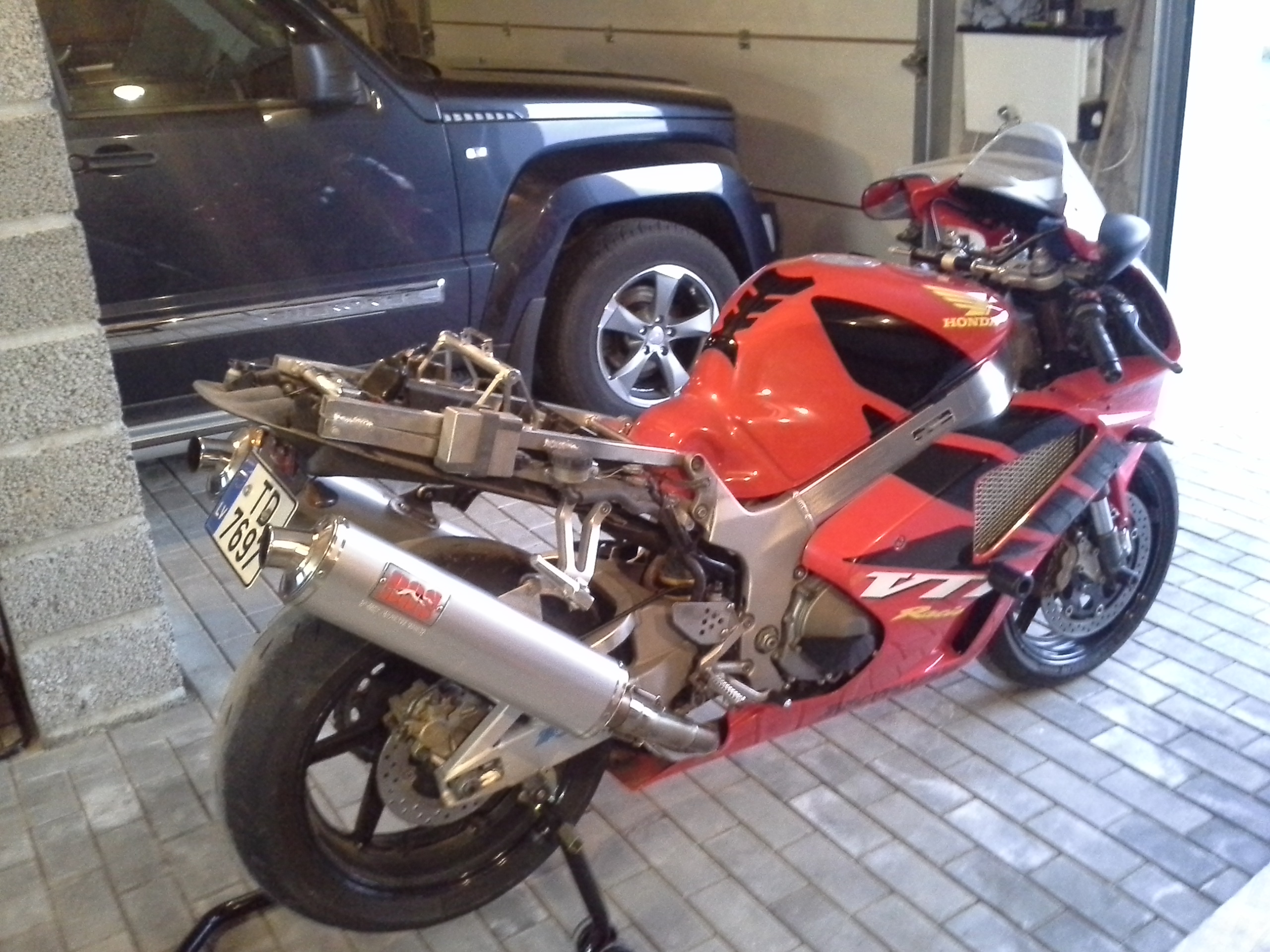

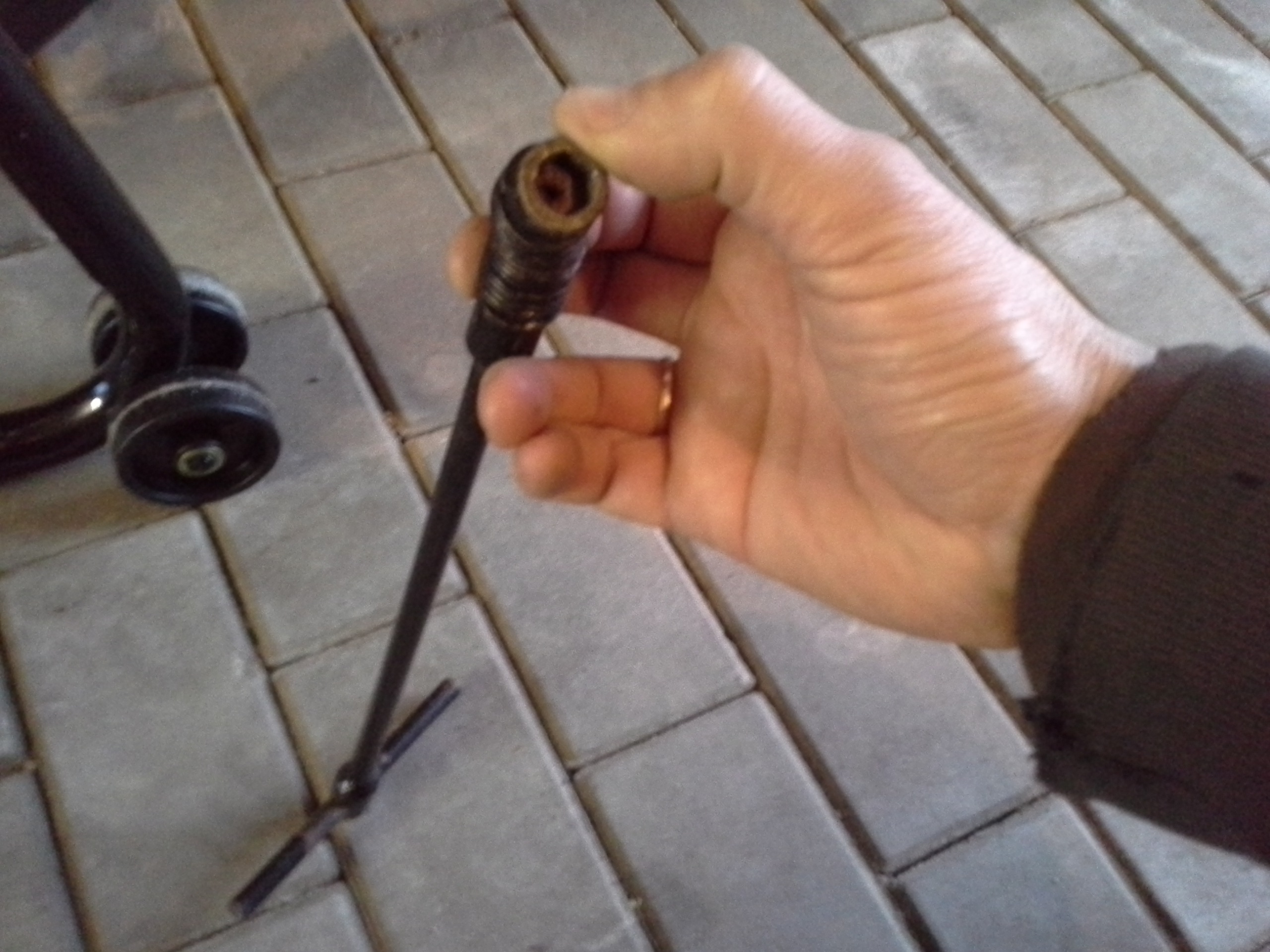

Postby ekskavator » Sun Mar 30, 2014 1:52 pm
Yesterday through ride, I had fined the same problem :( , all connectors was checked and cleaned.
Unfortunately nothing happened :( Tomorrow drive to work through big H dealership, for purchase a new speedo-sensor. How Hunberg write before, it wasn't easy to screw up this sensor from gearbox, but I was very lucky to fined some old school equipment in my tool box :)
