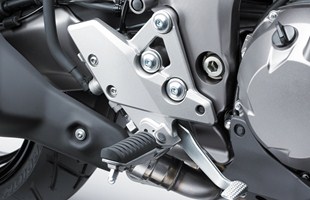

Can you not either put rubber washers between the frame and the hanger or see if you can get some pegs with a rubber cover on top? I'm not sure what models you could use but there must be something out there thats just a straight swap?

Are there any footrest with rubber cover (as shown in your picture)? I suppose this absord as well the vibrations?
Any idea on where I can get these footrests?

Sorry mate, I've no idea what might be a straight swap. It might be a case of either looking through demon tweeks or M and P to see what models have the same part numbers of aftermarket pegs or take one of your pegs off and have a look around some bike shops, even then you might need to modify it a little?
