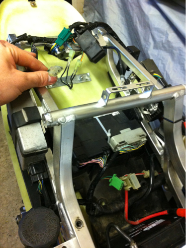

Postby hannakournikova » Wed Jul 25, 2012 10:50 pm
Wonder if anyone can help identify the unused connector blocks to see what their for.
The white 3 way I'm holding in pic and green 3 war in front of ECU

Postby Dmac » Thu Jul 26, 2012 10:49 pm
I think the connector in your hand is one of the rear light ones.
I Had a look today, My standard set-up has two connnectors with three wires in each. For each of the bulbs in the rear light.
Couldnt see the green one from the boot, You have me wondering now, what its for :?: :x

Postby hannakournikova » Wed Mar 27, 2013 4:26 pm
sorry to bump this. But the last picture, the clear 3 pin connector doesnt fit standard lights.

Postby Neil McClure » Wed Mar 27, 2013 8:56 pm
Ive just stripped my rear lights out and that is the same as on mine, there is two of them as its a double lens fitment. Dont know what the green is but I will look see if I have this.

Postby VTRdan » Thu Mar 28, 2013 1:06 pm
I've had mine in pieces for a few weeks now, the white 3 pin connector is for the stock tail lights (or at least, it looks identical to the ones I have.)
The green one is a bit more of a mystery, it looks the same style as the indicator connector (on the loom side of things) but on my SP1 the left indicator is a blue connector and the right one is orange. If I was in your situation I'd get a multimeter and start flicking switches to see if there's power to the pins and see where it's coming from.
