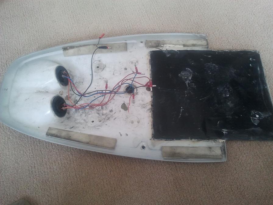

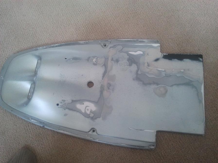

The hotbodies underseat had taken a battering not only from stones but also when the badly positioned number plate hit the hugger in a big dip smashing hugger , plate and underseat in the process so i decided it was time to strengthen the unit with some ABS sheet and a plastic welding gun from work. Also cut away the trough for the virtically mounted ECU as not needed on the SP1 for a cleaner look ;) Then all P38'd up and sanded ready for high build primer. May well completely ditch the OEM battery holder so the extra ABS will support :P

will respray with cheapo Halfords silver as exact match not need and RS paint is too pricey and pretty shit :thumbup:

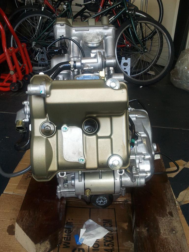

well thanks to you mate it will be the new engine going in but it will be nice to get the old mill up and running again, and i have the spares to keep this bike going way past my ability to swing a leg over it!

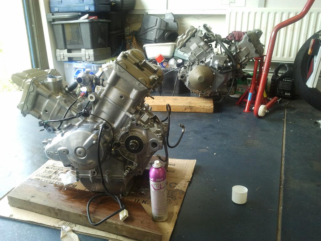

new and old, sprayed new with ACF , fitted PAIR block off plates and new steering bearings to frame then ready for frame to drop on.

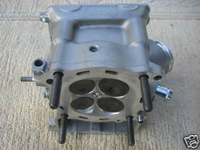

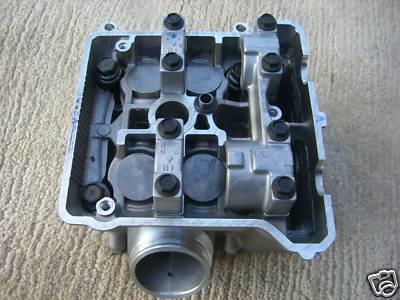

Fookin typical! as you can see from the above picture of the cylinder head it is clearly a front head but ive been sent the rear instead from Germany. However, two days ago i stripped out the cams from the rear head on my bike to find them and the journals slightly scored as well. it may be that this head is useless as well. My plan now is to send both heads off to Roger for his input, and if he says they are both fooked then this new rear head c/w valves and cams (for only £130) will be used and i have bought another (front head) from the Krauts for (£130) this one with only the valves (but i allready have the exhaust cam). basically with just one inlet cam to buy for the front i will be able to re build a standard engine, or if the rear head is ok then get the front head ported etc.
it now appears that the original fault could be oil pump related so this will be checked thoroughly.
