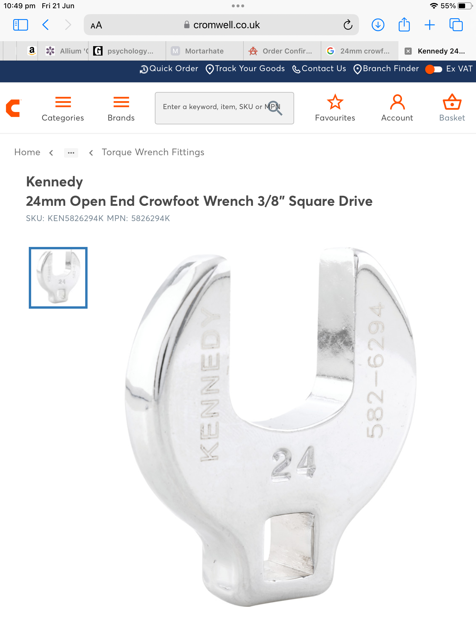

To anyone thinking of replacing their fuel pressure regulator.
It can be done without removing the fuel tank, just prop it up as far as you can (but watch for stretching the hoses) but please make sure your tank is empty of fuel (a draper manual fuel pump helps here, google is your friend here.)
I purchased a 24mm spanner to do the job as the nut on the fuel pressure regulator is 24mm but hell fire the spanner for that size is huge. So after trawling through the web for a few days i found a 24mm crowfoot spanner would do the job perfectly, it’s basically a spanner head without the neck.
This fits onto a ratchet and did the job perfectly.
As below:
https://www.cromwell.co.uk/shop/hand-to ... EN5826294K
