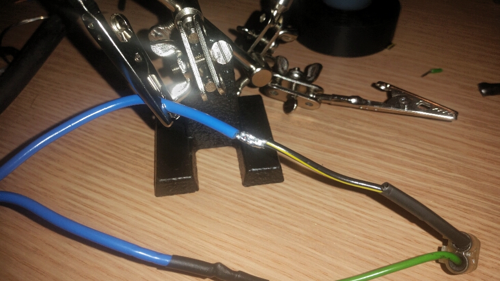

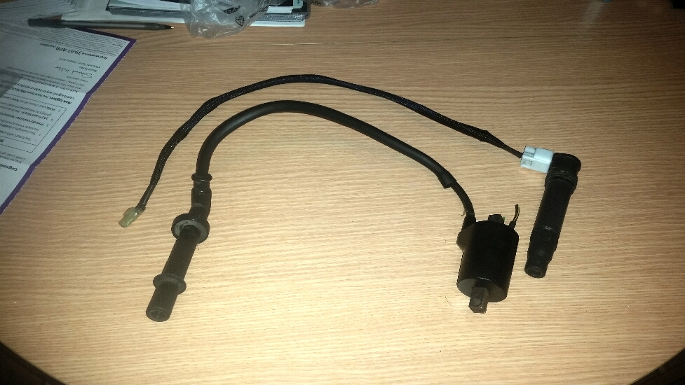

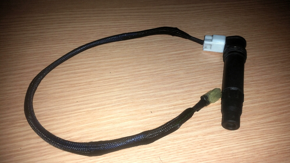

I've done the mod on my SP2 mate. I used cbr600rr 2005 plug top coils and you need the coil harness as well then make two wire lòms to replace the ht leads.
Re: SP1 Coil Mod????
Postby sparkysp2 » Fri Jun 05, 2015 7:21 pm
A few pics.
Postby Neil McClure » Fri Jun 05, 2015 7:43 pm
Thats what to do. Easy peasy. Done it to my SP1 same way.
