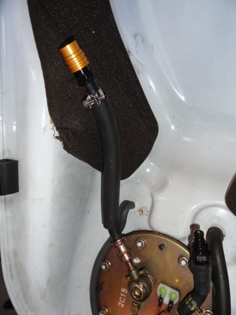

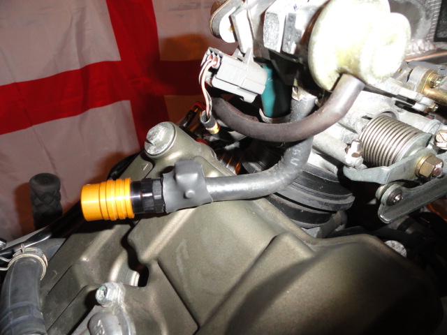

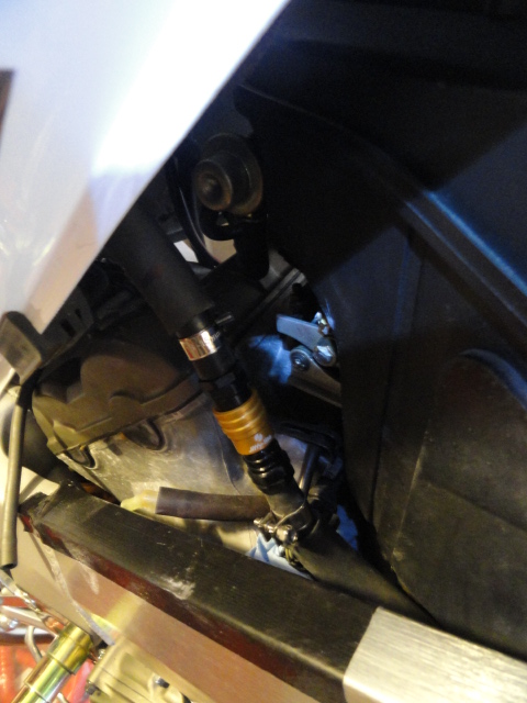

Postby mad65sp » Thu May 14, 2015 8:16 pm

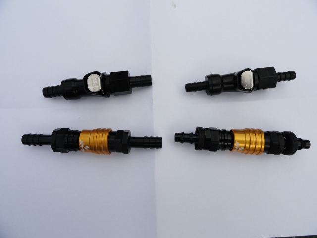

Well I finally got around to deciding on which dry break connectors and then fit them.
I went with the Jiffy Tite connector even though they cost £100 against £30 pound for the other version in the photo that I got off ebay.
I went with the Jiffy Tite on build quality and a couple of friends have had the other version in the photos for £30 fail, not something you want when dealing with fuel.
FYI.
The feed hose size is 8mm or 5/16 and the return hose is 6mm or 1/4".
The part numbers for the jiffy tite connectors are.
JT 22504P, PLUG 1/4" P/O VALVED.
JT 21504P, SOCKET 1/4" P/O VALVED.
JT 22505, PLUG 5/16 P/O VALVED.
JT 21505, SOCKET 5/16 P/O VALVED.
Well all is fitted and getting the tank of is a lot easier :D

Postby pirks » Thu May 14, 2015 10:09 pm
I got some Jiffytite ones for the feed hose but havent got around to fitting them yet, they do look like very good quality stuff though.
Do they flow both ways or do they have to be fitted in a certain direction?

Postby mad65sp » Fri May 15, 2015 5:28 pm
Yes they flow both ways and the return hose loses a lot of fuel when you disconnect.
Don't forget measure twice cut once, when you push the connectors into the fuel line you wont get them out if you have them in wrong place.
A new genuine Honda fuel feed line is about £200 if you get it wrong :angry-banghead:
Good luck :thumbup:

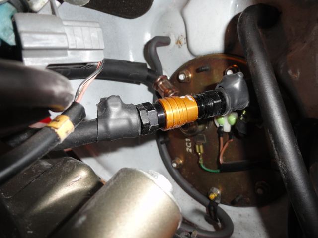

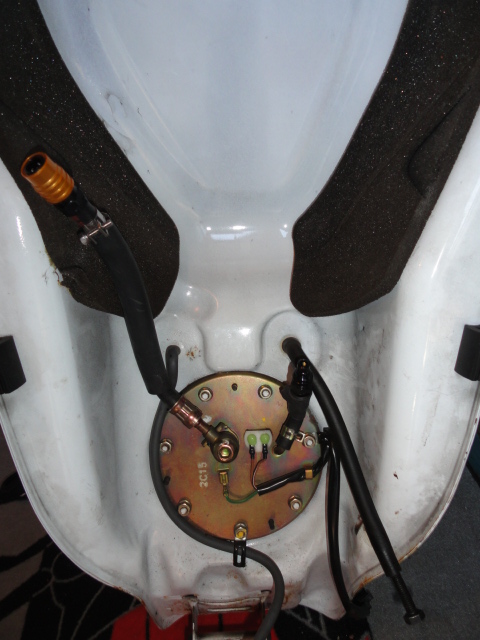

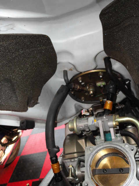

Postby mad65sp » Sat May 16, 2015 8:56 pm
Well its been a busy day, after fitting the fuel connectors and get the tank off, I could then do the shims and then change the coolant hoses and change the plugs and now all done :D .
I've attached some more photos and anything else you want to know let me know :thumbup:
