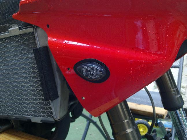

I had the carbon look ones like Jon but wasnt too keen so sorted my own out
I bought some LED Firestorm ones off ebay, made a little ally plate just biger than the hole in the fairing as one of the owners had butchered it to fit some other indicaters at some point :doh: and theyre the same size as the hole anyway, then another plate to fit behind it.
Its holds itself in place and they come off easy! Indicater, outer plate, fairing, second plate and large screw thing :thumbup:
