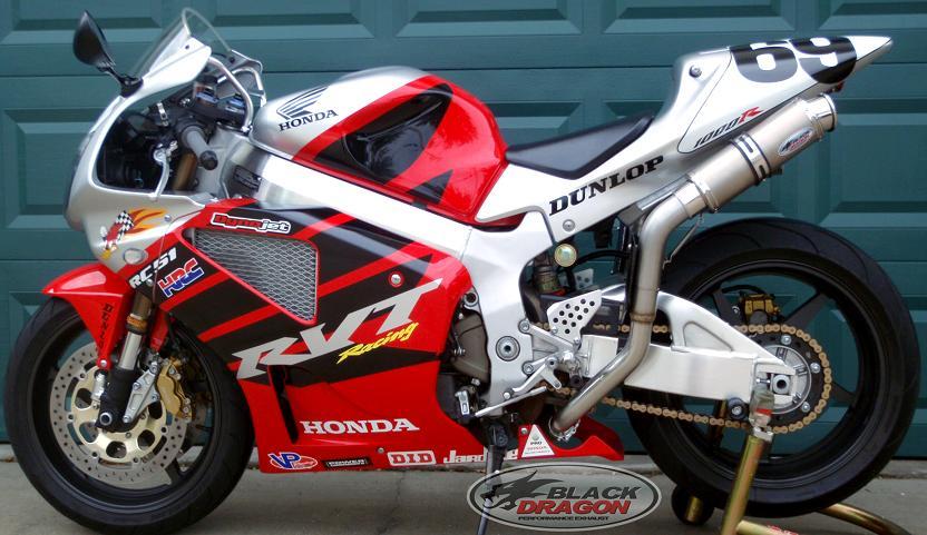

Choosing an exhaust for your bike is a mine field, especially with the big twins. If you're not too bothered about small power loss or gains then choose the system you like the look of weather it be big bore Moto GP style cans or high levels with single sized mid pipes etc. Tests by more than one manufacturer have shown that the best power gains come to low level sytems with conical header design, in fact very similar to the OEM system but without being over silenced (by being open no baffles). As i have found out to my expense the end cans regardless of style need to be packed properly (epsecially the carbon cans) and if not the packing can blow and burn away causing power losses and excess noise :o . The overall length of the system is important (mid pipes and silencer added together) so Moto GP cans would probably show better power gains if the mid pipes were longer reaching them to where the OEM silencer outlet would normally be, but this would look wrong. System diameter is critical as it must be wide enough to get rid of the gases quickly but not too wide that the exhaust gas speed is reduced which is why the HRC systems are fairly useless on the standard engine as not only will it not fit on standard cylinder heads but it too wide a bore and suited to high flow engines. It really is worth paying for a quality system with a history of R&D behind it as its the R&D that costs, if you look at the actual materials involved against cost you could never really have a go at the missus again for paying £150 on a pair of sandles ;) What that chap said to Sppete was right about paying for a proven system IMO.
On the subject of Moto GP styles i think these look the dogs bollocks.
it really is down to personal choice at the end and of course budget but these are classy bikes which deserve the mistress treatment with diamonds :D
