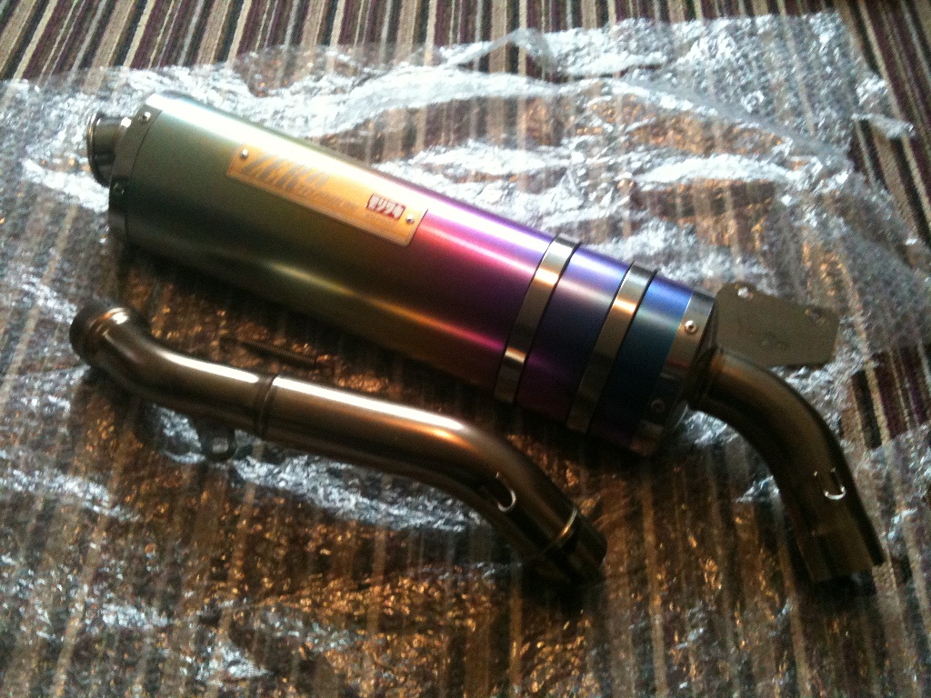

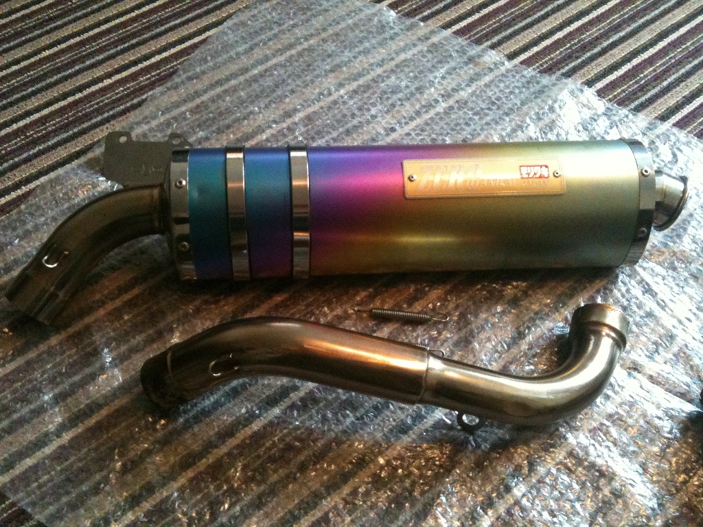

What a difference a week makes! I have done a deal with a mate and secured these:-
Pucka Moriwaki Zero Ti :geek: :geek: :geek: :dance: :dance: :dance:
