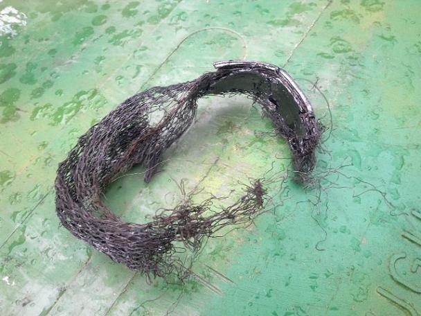

Just a quick question about replacing an exhaust gasket as mine failed on the way home from passing its MOT yesterday :evil: :angry-banghead: not great but at least it didnt happen on the way there :thumbup:
Anyway its the gasket between the pipe coming out of the rear cylinder and the collector box section.
Do I need to replace all the gaskets and take the lot apart or can I slacken the joints off and just replace the one that ended up wedged in the DB killer?
Moral of the story is not to put the DB killers in as this caused the extra pack pressure leading to the gasket failing. This is the reason officer I cant ride around with them in :lol:
Thanks in advance guys
