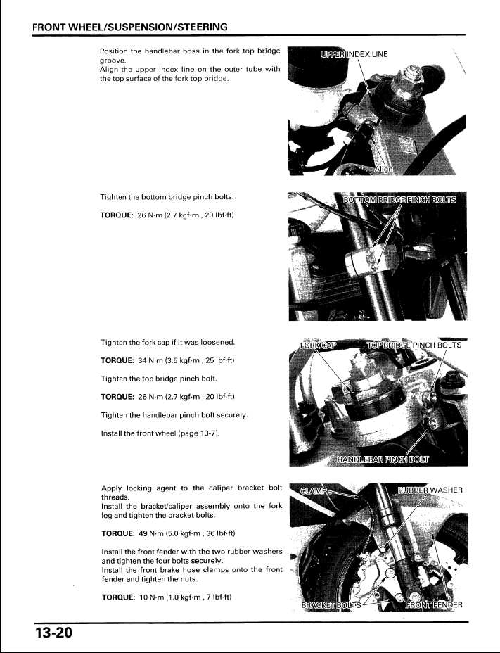

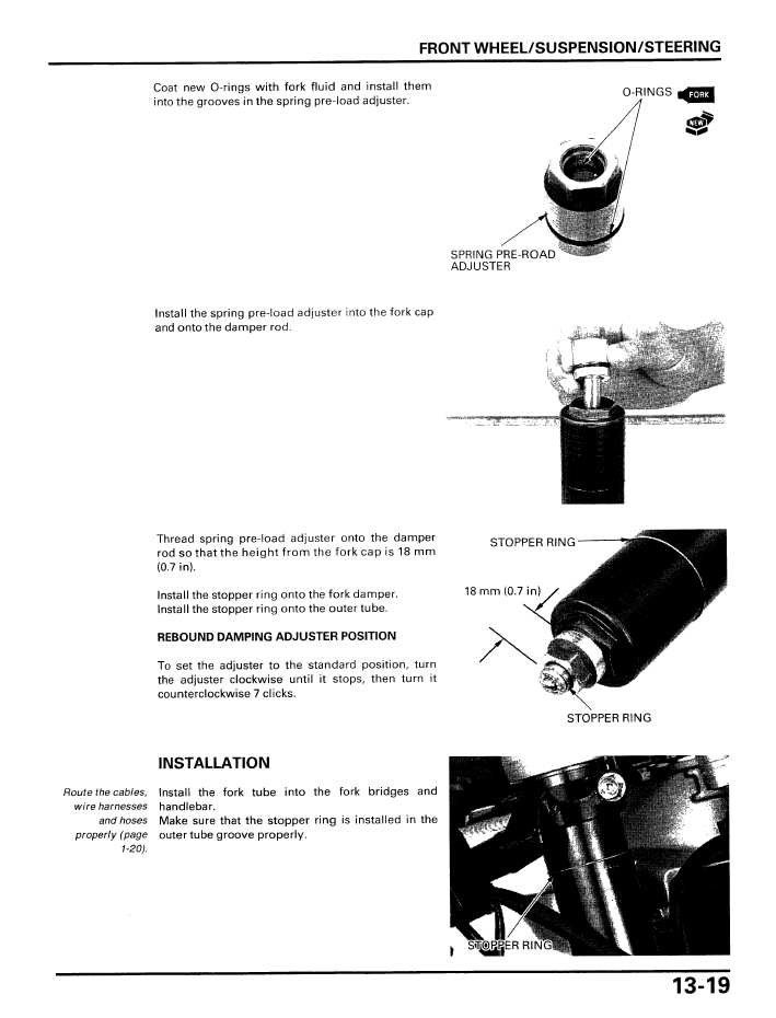

My forks are dropped well through the tripples and want to raise them back up a bit.
Are the measurements given to the bottom of the blue cap or the top.
Any idea how to support the bike without a paddock stand to allow me to raise them through.

Postby VTRSP2 » Sat Apr 14, 2012 6:50 pm
From the Honda Workshop Manual, this should give you the info you need:-

Postby David451 » Sun Apr 15, 2012 2:55 pm
VTRSP2 wrote:From the Honda Workshop Manual, this should give you the info you need:-
Hope that helps :thumbup:
Thanks for that, all I need to do is figure a way to take the weight to allow me to move them now.
