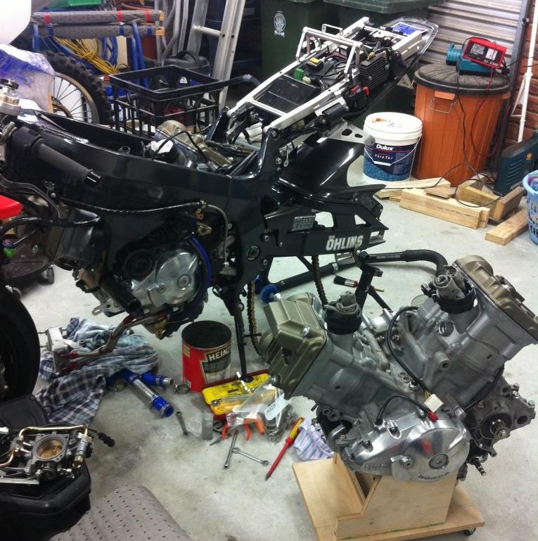

New Engine ready to go.jpg (222.49 KiB) Viewed 16613 times

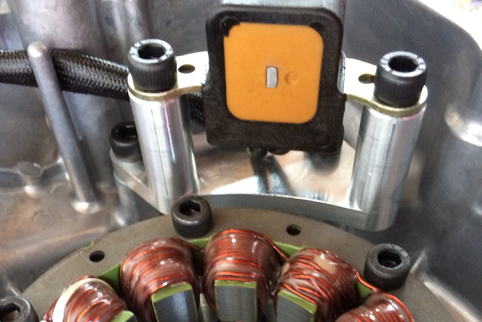

I found and purchased a new race kit from Electrex World Ltd, the kit is made really well but doesn't work! [unbelievable given they claim been making them for eight years :P ]
Now, the run down of events...……………………….
1/ Purchased 2nd April £489.28 VAT exc.
2/ Sent an email through the web portal requesting availability of the kit and estimated delivery time [no response] same day of purchase
3/ After three emails I got a response via a direct email address …….. "Hello Mark, apologies for the delay. We are having to make the stator for this kit; I will have a better idea tomorrow when the kit can be available." [10th Apr so it took 8 days to get a response :angry-banghead:]
4/ Kit was shipped on the 12th Apr express DHL - great service from them!
5/ Kit arrived 16th Apr, looks great and 'the real business' - happy so far.
6/ Its now Sat 21st Apr going to install the kit :D
7/ I have a bit of experience with race kits so should be a walk in the park, NOW this is were it all starts to go to shit.
- No instruction, is a bit of a surprise given most countries require it, not a big deal as I said before, been here many times before.
- The kit has machine screws of a few sizes 3x countersunk [no countersunk holes on the kit?] anyway after quickly allocating what goes were two screws left over to mount a Rect/Reg of different lengths [not a big deal but, been building this for eight years!]
- The Rect/Reg unit supplied is a two wire ouput unit and the OEM wiring is a three wire unit one wire goes through the killswitch /ignition switch
[this can't be fixed by simply joining the two (+ve) wires together as this changes how the system works i.e. the ignition key will not turn the engine off [from previous challenges]
- Hence no instructions [great]
- The stator has an OEM plug to suit the OEM Rect/Reg unit 'the output cable is 60% too short to reach the Rect/Reg unit'...… again, been making them for 8 years!
8/ As expected a new gasket will be required £11 each [ended up using Qty.3] $$$$$$
9/ Pulled the bike apart and removed the engine sidecover and removed all the OEM gear, Stator, Pulse Generator and Flywheel off the Crank.
10/ Install all of the kit [except the Rect/Reg unit retaining the original unit] and manufactured an extension wiring lead for the Stator output
11/ THE BIG MOMENT- START TIME :angry-banghead:
12/ The bike Did Not Want to Start at All, I ran the battery flat trying, didn't even fire at all. The bike starts normally very quickly and every time in standard configuration.
13/ Sent an email off to Electrex World Ltd on the 21st Apr and explained what had happened, yep no reply!
14/ Sent another email on the 25th Apr requesting a reply
15/ Finally got a reply from the receptionist "Thank you for your email. Unfortunately the Tech guy has been away for a week or so but will be back on Monday...……."
16/ Sent another email on the 3rd May requesting a reply from the Tech Guys...… still haven't a reply 5th May :evil:
What a Bullshit company this lot are, stay clear.
The kit obviously doesn't work and its in the Pulse Generator area where the issue is, I manufactured a new mounting bracket to move the pickup closer to the flywheel similar to the OEM air gap...... not the massive gap using the EW kit bracket [OEM = 0.35mm EW= 0.65mm]
The bike just barely started but was running very rich and took the bike for a ride, turned around after 1km and went home and removed the kit from the bike reverting it back to standard and YES it started and ran like a dream - fantastic.
My assumption is, the RPM signal being generated is 'Confused' and causing the problem, the induction segments [qty 12] on the flywheel are not as high as the OEM [OEM=3.18mm EW= 1.82mm]
I know how to fix the issue but will cost @ £230 in machining and after all its a kit, that they have been manufacturing for 8 years. There are just too many discrepancies between the OEM clearances/spec and what they are suppling in the RPM generator area.
Anyone looking to purchase this kit 'buyer beware' especially if you reside overseas.

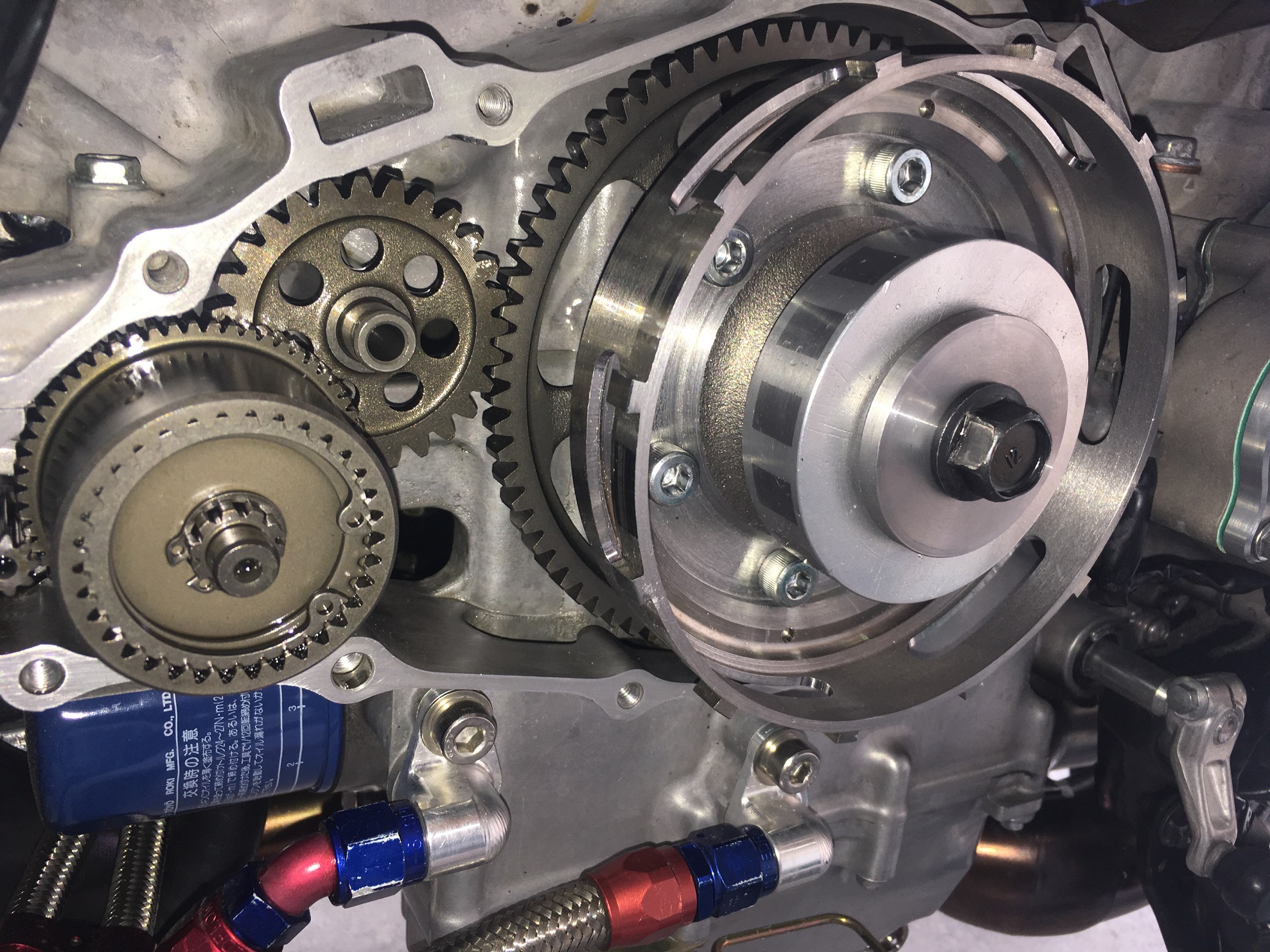

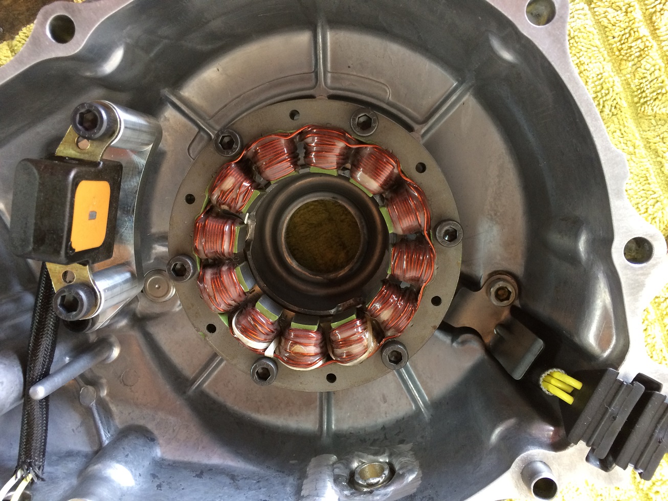

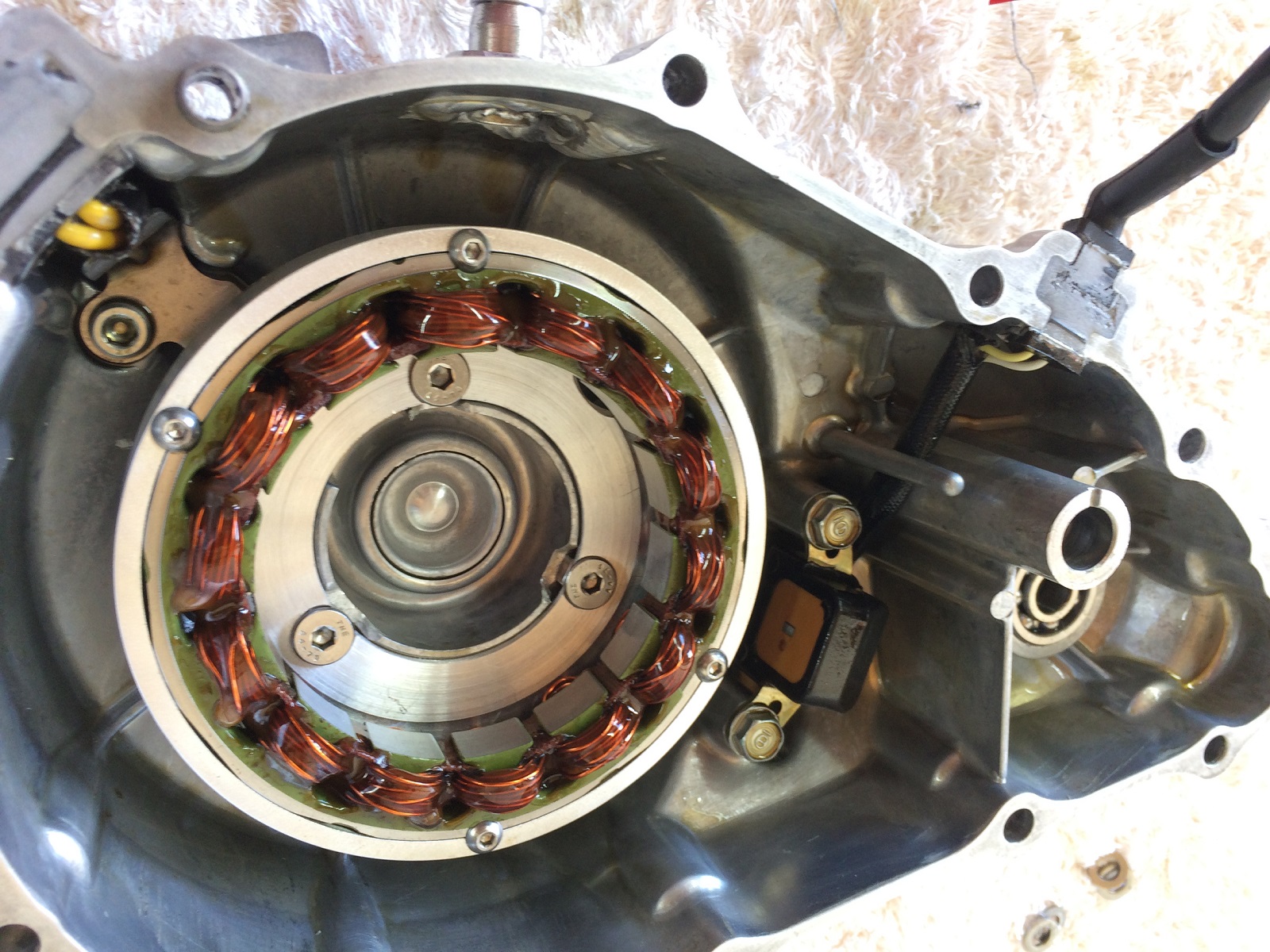

Generator sidecover
Stator and Pickup mounted in case .JPG (431.32 KiB) Viewed 15847 times

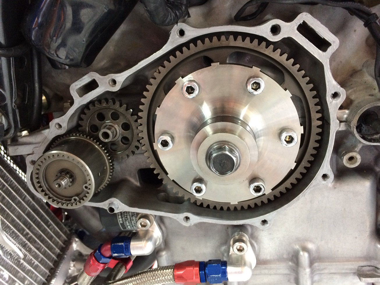

Electrex World Flywheel
Electrex World Flywheel.JPG (431.21 KiB) Viewed 15847 times
Stator and Pulse Gen Bracket
Generator mounted.JPG (211.58 KiB) Viewed 15847 times
