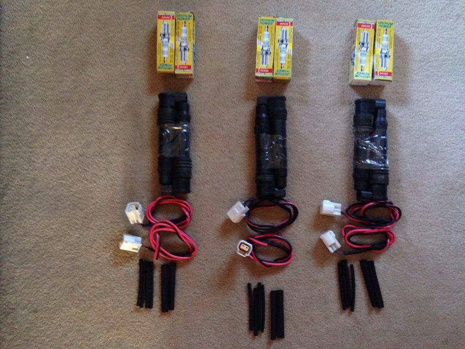

Postby sparkysp2 » Wed Apr 13, 2016 4:05 pm
I'm UK based have the same plug and play kit with solder less looms £85 including postage in the UK

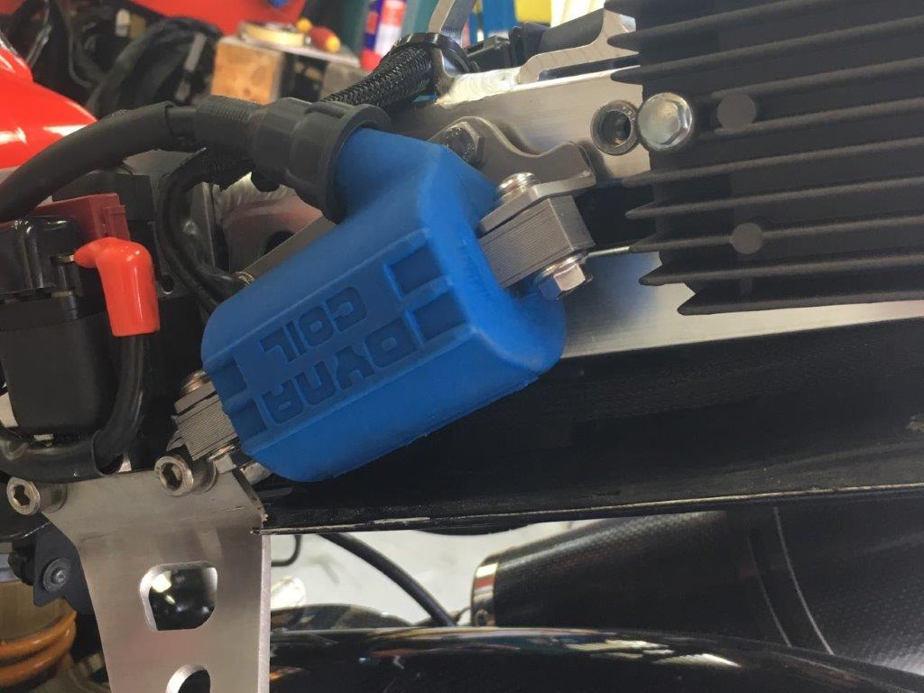

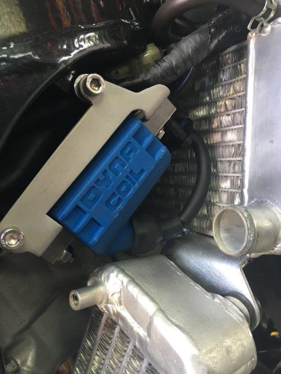

Postby Mark L » Sun Apr 09, 2017 5:54 am
Hi All,
One of the best bang for buck, mod I have done is to upgrade the coils and plugs.
I wouldn't recommend stick coils at all as everything I have read on them doesn't suggest an improvement in a positive direction quite the reverse.
and the other thing is one has to butcher the plugs to make them fit.

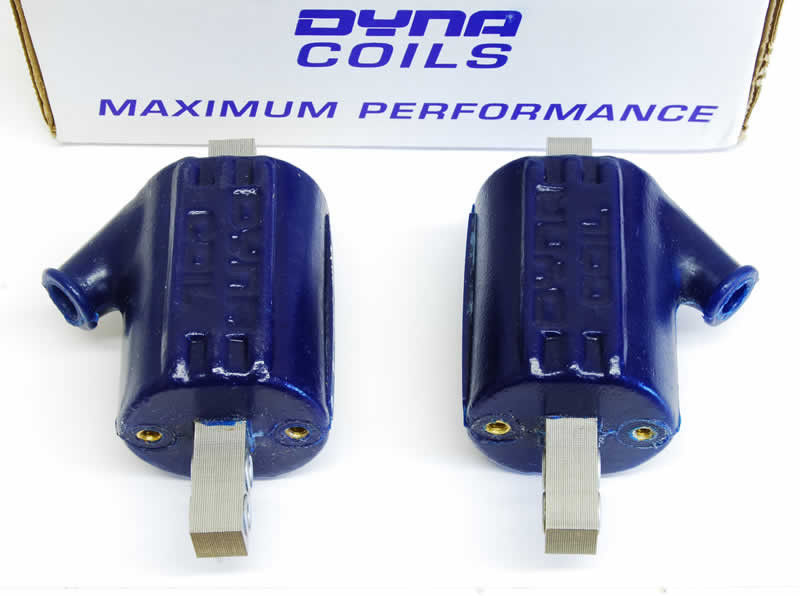

I fitted a pair of DYNA 4000 DC9-4 DYNATEK BLUE IGNITION COILS 0.7 OHM and DENSO Race Plug IK31, the change was so great I had to remap the fuel loads.
http://www.dynatekuk.com/accessories_dyna_coils.html
All up under $300 AUD, coils were the cheapest out of the USA, HT leads and fittings out of UK and reused the OEM plug caps.
The hardest part is making the brackets and making it all fit on the bike.
